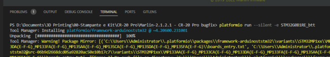

@eaman l'ho postato completo nel post sopra... l'errore e' lo stesso
PS D:\Documents\3D Printing\00-Stampante e Kit\CR-20 Pro\Marlin-2.1.2.1 - CR-20 Pro bugfix> platformio run --silent -e STM32G0B1RE_btt
Tool Manager: Installing platformio/framework-arduinoststm32 @ ~4.20600.231001
Unpacking  [####################################]  100%
Tool Manager: Warning! Package Mirror: [('C:\\Users\\Administrator\\.platformio\\packages\\framework-arduinoststm32\\variants\\STM32MP1xx\\MP133AA(E-F-G)_MP133CA(E-F-G)_MP133DA(E-F-G)_MP133FA(E-F-G)_MP135AA(E-F-G)_MP135CA(E-F-G)_MP135DA(E-F-G)_MP135FA(E-F-G)\\boards_entry.txt', 'C:\\Users\\Administrator\\.platformio\\packages\\framework-arduinoststm32@src-06b9d2668dcd05a92820ac50e10b17c7\\variants\\STM32MP1xx\\MP133AA(E-F-G)_MP133CA(E-F-G)_MP133DA(E-F-G)_MP133FA(E-F-G)_MP135AA(E-F-G)_MP135CA(E-F-G)_MP135DA(E-F-G)_MP135FA(E-F-G)\\boards_entry.txt', "[Errno 2] No such file or directory: 'C:\\\\Users\\\\Administrator\\\\.platformio\\\\packages\\\\framework-arduinoststm32@src-06b9d2668dcd05a92820ac50e10b17c7\\\\variants\\\\STM32MP1xx\\\\MP133AA(E-F-G)_MP133CA(E-F-G)_MP133DA(E-F-G)_MP133FA(E-F-G)_MP135AA(E-F-G)_MP135CA(E-F-G)_MP135DA(E-F-G)_MP135FA(E-F-G)\\\\boards_entry.txt'"), ('C:\\Users\\Administrator\\.platformio\\packages\\framework-arduinoststm32\\variants\\STM32MP1xx\\MP133AA(E-F-G)_MP133CA(E-F-G)_MP133DA(E-F-G)_MP133FA(E-F-G)_MP135AA(E-F-G)_MP135CA(E-F-G)_MP135DA(E-F-G)_MP135FA(E-F-G)\\generic_clock.c', 'C:\\Users\\Administrator\\.platformio\\packages\\framework-arduinoststm32@src-06b9d2668dcd05a92820ac50e10b17c7\\variants\\STM32MP1xx\\MP133AA(E-F-G)_MP133CA(E-F-G)_MP133DA(E-F-G)_MP133FA(E-F-G)_MP135AA(E-F-G)_MP135CA(E-F-G)_MP135DA(E-F-G)_MP135FA(E-F-G)\\generic_clock.c', "[Errno 2] No such file or directory: 'C:\\\\Users\\\\Administrator\\\\.platformio\\\\packages\\\\framework-arduinoststm32@src-06b9d2668dcd05a92820ac50e10b17c7\\\\variants\\\\STM32MP1xx\\\\MP133AA(E-F-G)_MP133CA(E-F-G)_MP133DA(E-F-G)_MP133FA(E-F-G)_MP135AA(E-F-G)_MP135CA(E-F-G)_MP135DA(E-F-G)_MP135FA(E-F-G)\\\\generic_clock.c'"), ('C:\\Users\\Administrator\\.platformio\\packages\\framework-arduinoststm32\\variants\\STM32MP1xx\\MP133AA(E-F-G)_MP133CA(E-F-G)_MP133DA(E-F-G)_MP133FA(E-F-G)_MP135AA(E-F-G)_MP135CA(E-F-G)_MP135DA(E-F-G)_MP135FA(E-F-G)\\PeripheralPins.c', 'C:\\Users\\Administrator\\.platformio\\packages\\framework-arduinoststm32@src-06b9d2668dcd05a92820ac50e10b17c7\\variants\\STM32MP1xx\\MP133AA(E-F-G)_MP133CA(E-F-G)_MP133DA(E-F-G)_MP133FA(E-F-G)_MP135AA(E-F-G)_MP135CA(E-F-G)_MP135DA(E-F-G)_MP135FA(E-F-G)\\PeripheralPins.c', "[Errno 2] No such file or directory: 'C:\\\\Users\\\\Administrator\\\\.platformio\\\\packages\\\\framework-arduinoststm32@src-06b9d2668dcd05a92820ac50e10b17c7\\\\variants\\\\STM32MP1xx\\\\MP133AA(E-F-G)_MP133CA(E-F-G)_MP133DA(E-F-G)_MP133FA(E-F-G)_MP135AA(E-F-G)_MP135CA(E-F-G)_MP135DA(E-F-G)_MP135FA(E-F-G)\\\\PeripheralPins.c'"), ('C:\\Users\\Administrator\\.platformio\\packages\\framework-arduinoststm32\\variants\\STM32MP1xx\\MP133AA(E-F-G)_MP133CA(E-F-G)_MP133DA(E-F-G)_MP133FA(E-F-G)_MP135AA(E-F-G)_MP135CA(E-F-G)_MP135DA(E-F-G)_MP135FA(E-F-G)\\variant_generic.cpp', 'C:\\Users\\Administrator\\.platformio\\packages\\framework-arduinoststm32@src-06b9d2668dcd05a92820ac50e10b17c7\\variants\\STM32MP1xx\\MP133AA(E-F-G)_MP133CA(E-F-G)_MP133DA(E-F-G)_MP133FA(E-F-G)_MP135AA(E-F-G)_MP135CA(E-F-G)_MP135DA(E-F-G)_MP135FA(E-F-G)\\variant_generic.cpp', "[Errno 2] No such file or directory: 'C:\\\\Users\\\\Administrator\\\\.platformio\\\\packages\\\\framework-arduinoststm32@src-06b9d2668dcd05a92820ac50e10b17c7\\\\variants\\\\STM32MP1xx\\\\MP133AA(E-F-G)_MP133CA(E-F-G)_MP133DA(E-F-G)_MP133FA(E-F-G)_MP135AA(E-F-G)_MP135CA(E-F-G)_MP135DA(E-F-G)_MP135FA(E-F-G)\\\\variant_generic.cpp'"), ('C:\\Users\\Administrator\\.platformio\\packages\\framework-arduinoststm32\\variants\\STM32MP1xx\\MP133AA(E-F-G)_MP133CA(E-F-G)_MP133DA(E-F-G)_MP133FA(E-F-G)_MP135AA(E-F-G)_MP135CA(E-F-G)_MP135DA(E-F-G)_MP135FA(E-F-G)\\variant_generic.h', 'C:\\Users\\Administrator\\.platformio\\packages\\framework-arduinoststm32@src-06b9d2668dcd05a92820ac50e10b17c7\\variants\\STM32MP1xx\\MP133AA(E-F-G)_MP133CA(E-F-G)_MP133DA(E-F-G)_MP133FA(E-F-G)_MP135AA(E-F-G)_MP135CA(E-F-G)_MP135DA(E-F-G)_MP135FA(E-F-G)\\variant_generic.h', "[Errno 2] No such file or directory: 'C:\\\\Users\\\\Administrator\\\\.platformio\\\\packages\\\\framework-arduinoststm32@src-06b9d2668dcd05a92820ac50e10b17c7\\\\variants\\\\STM32MP1xx\\\\MP133AA(E-F-G)_MP133CA(E-F-G)_MP133DA(E-F-G)_MP133FA(E-F-G)_MP135AA(E-F-G)_MP135CA(E-F-G)_MP135DA(E-F-G)_MP135FA(E-F-G)\\\\variant_generic.h'")]
Si ma un umano non puo' cercare di decifrare quel wall of text... 😞
Li' dice che ti manca un file, magari e' danneggiato il file system o non e' stato scaricato.
Ora dato che sei un utente windows su windows fai alla maniera di windows: re installa il sorgente o/e l'inter VSC, perche' navigare quei percorsi io non lo farei...
Mannaggia la pupazzaaaaaaaaa!!!!!!!!!!!!!!!!!!!!!!!!
ce l'ho fatta ma e' stata una lotta infinita!!!!!!
Morale della favola, ho disinstallato Tutti i plugin di visual studio e visual studio. Ho rinominato la cartella
C:\Users\Administrator\.platformio
e ho reinstallato tutto da capo. Ho poi scarica la bugfix, copiato i miei file config.h e config _adv.h, impostato l'env di default in platformio.ini (credo sia superfluo ma nn si sa mai) e ricompilato il tutto. A parte un paio di errorini cosmetici prontamente sisntemati e' andato tutto liscio
Morale della favola, adesso ho il mio bel fw con bugfix che mettero' sulla CR20, appena l'altra sara' in grado di stampare in modo accettabile, migro anche la CR20 a Klipper e mi dimentichero' di questo supplizio!!!!!!!
